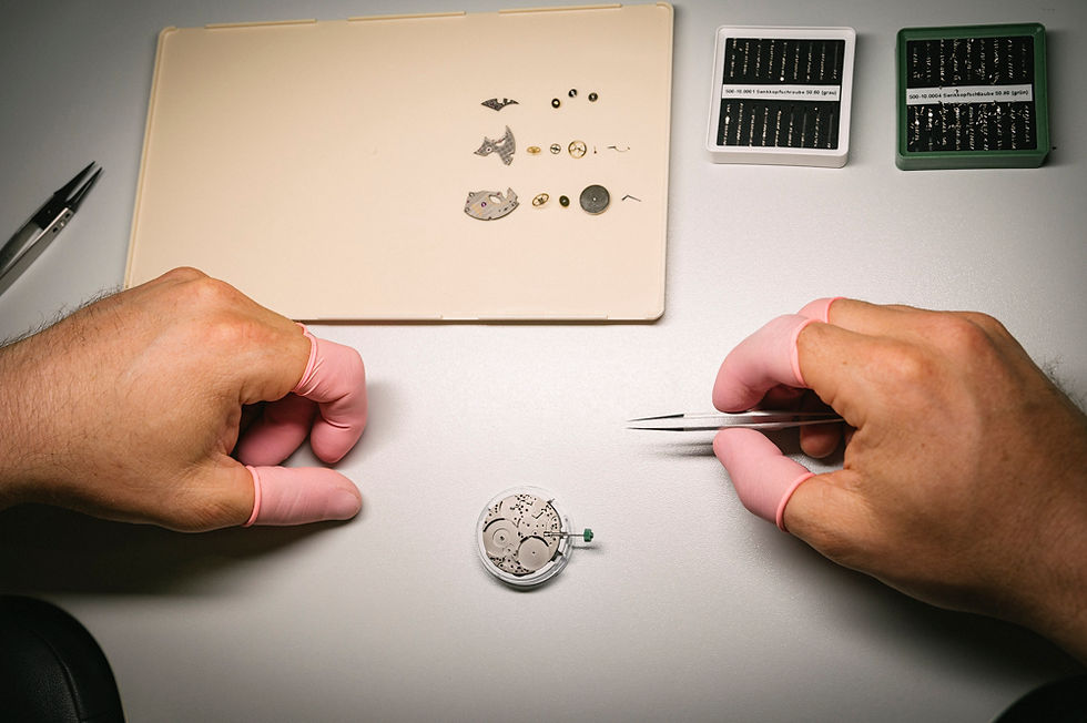

Jonas Nydegger at home at the bench. When you engineer something for 5 years the assembly process for each part and process is etched in ones mind.

The fun part is brining it all together and Jonas Nydegger the head of engineering has been waiting for the bridges to be completed. With endless zoom and skype calls Jonas has finally found a reason to escape and has been been focused on initial sample assembly.
A partially decorated build that awaits a finished rotor and balance wheel set for completion in the next week.
Although the rotors and balance wheels were still being finished Jonas wasn't going to wait any longer to start assembly. Stay tuned for an upcoming build video, where we join Jonas as he assembles the very first fully decorated K2 movements.
